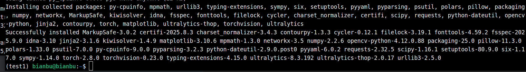

安装 ultralytics
pip install --prefer-binary ultralytics
等待安装完成,终端打印如下:

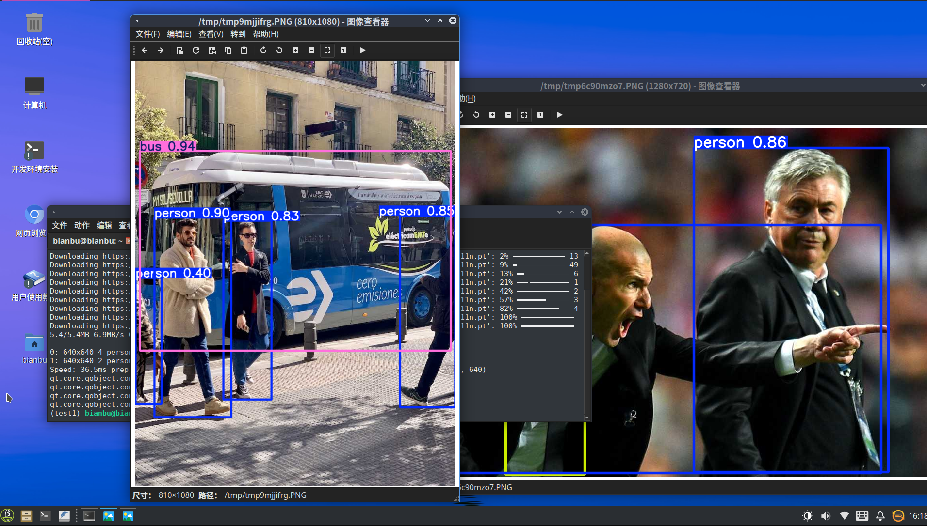

测试
示例参考来源:https://docs.ultralytics.com/zh/modes/predict/#plotting-results
由于涉及显示功能,请连接 HDMI 屏幕和键盘鼠标在板子本地运行命令。
from PIL import Image
from ultralytics import YOLO
# Load a pretrained YOLO11n model
model = YOLO("yolo11n.pt")
# Run inference on 'bus.jpg'
results = model(["https://ultralytics.com/images/bus.jpg", "https://ultralytics.com/images/zidane.jpg"]) # results list
# Visualize the results
for i, r in enumerate(results):
# Plot results image
im_bgr = r.plot() # BGR-order numpy array
im_rgb = Image.fromarray(im_bgr[..., ::-1]) # RGB-order PIL image
# Show results to screen (in supported environments)
r.show()
# Save results to disk
r.save(filename=f"results{i}.jpg")
保存为 demo1.py
执行:
source test1/bin/activate
python demo1.py
结果如下:
