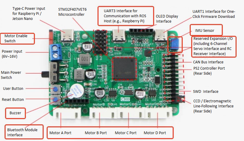

Motion Chassis (Wheeltec STM32 Controller)
Hardware Specifications The Wheeltec Educational ROS Differential Drive Robot uses an STM32 all-in-one control board as its chassis.
- Power Supply: Sourced from the battery, distributed to other components via T-cables or splitter cables.
- Signals: Originate from the K1 board, connected via dedicated cables to control motor and wheel movement.

Connect the chassis power cable (TypeC-to-TypeC) to the K1 board.
Turn on the chassis power switch and wait for the K1-Bianbu-desktop system to boot.
Connect the chassis signal cable (TypeC-to-USB) to the K1 board.
