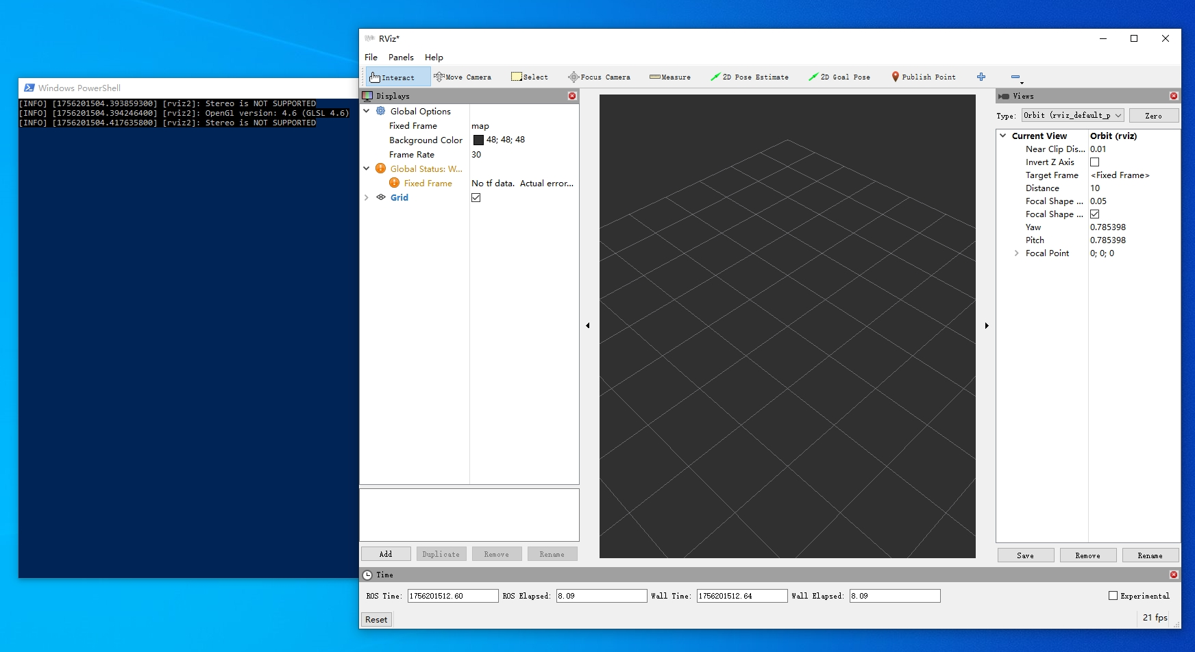

After installation, launch RViz2 with:
pixi run rviz2
