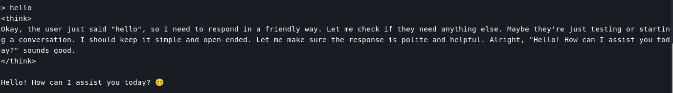

Usage
cd ~/spacemit-llama.cpp.riscv64.0.0.4/bin
./llama-cli -m ~/Qwen3-0.6B-Q4_0.gguf --threads 4

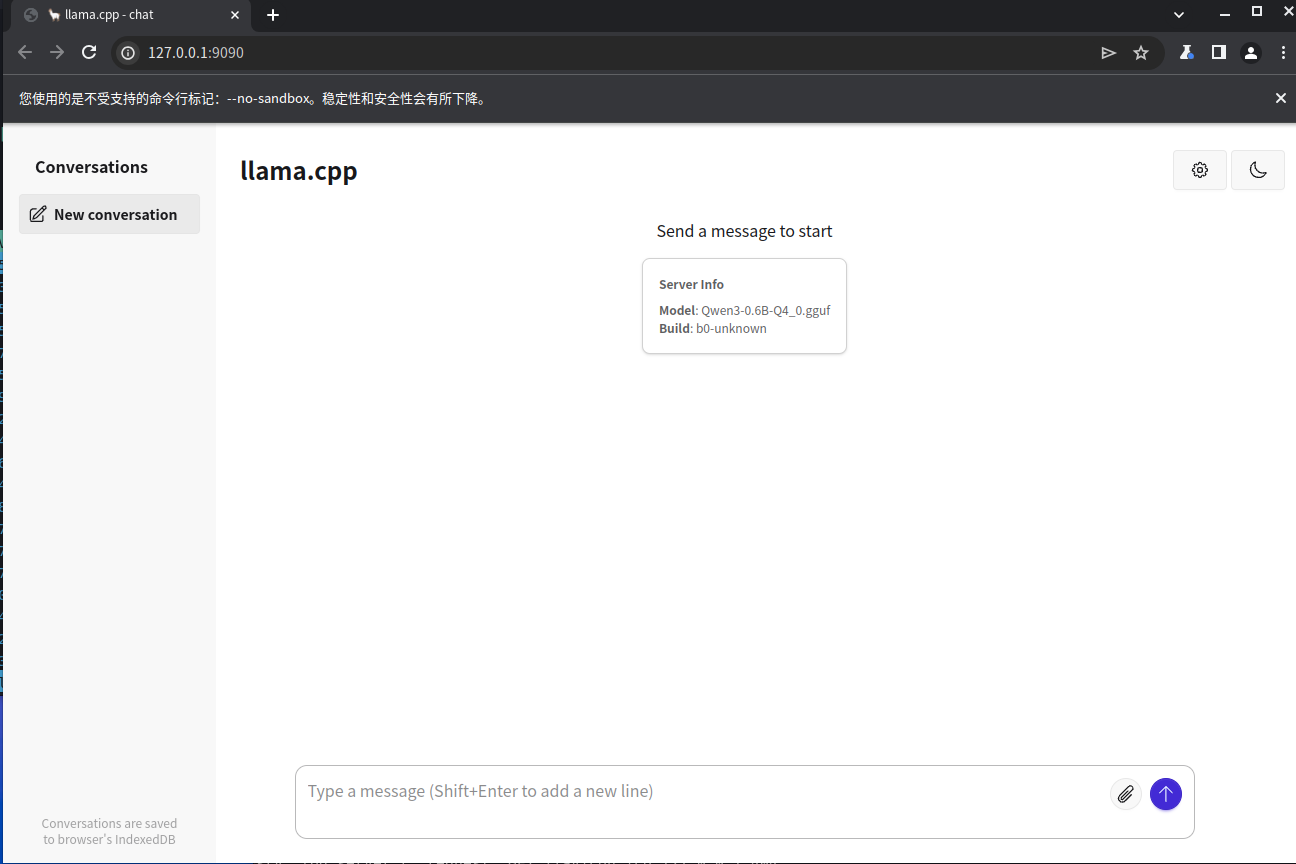

Browser usage
Open a browser and navigate to http://localhost:9090 to access the llama server and interact with llama.cpp directly in the browser.

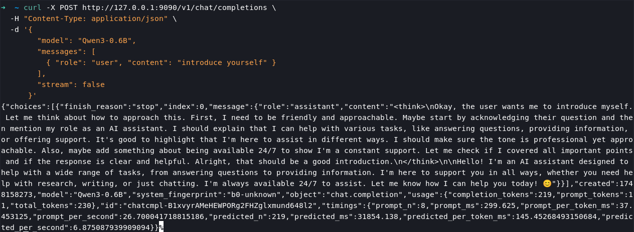

Local API Requests
Example:
curl -X POST http://127.0.0.1:9090/v1/chat/completions \
-H "Content-Type: application/json" \
-d '{
"model": "Qwen3-0.6B",
"messages": [
{ "role": "user", "content": "introduce yourself" }
"stream": false
