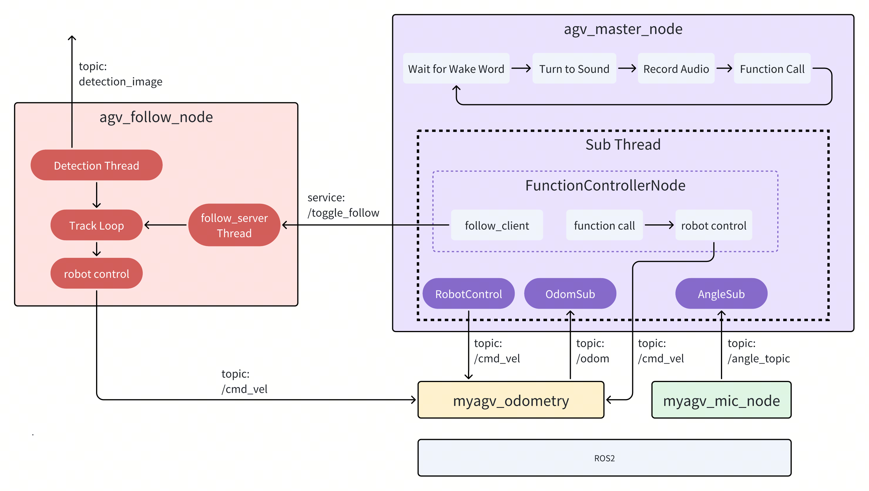

System Framework and Control Flow
The figure above shows the overall framework and process control of the AGV human-following case in the ROS2 system. It is mainly composed of the following four nodes:
  1. agv_master_node Master control node, responsible for overall process management.
    • Listens to the /angle_topic topic to obtain wake-up status and wake-up angle information;
    • Publishes to the /cmd_vel topic to control the AGV to turn to the target angle;
    • Calls spacemit_audio/record.py to perform recording, and executes function calls based on the recording (managed by the FunctionControllerNode);
    • Decides whether to start following based on the voice command result (triggered via the /toggle_follow service);
    • Other control commands are published directly through /cmd_vel.
  2. agv_follow_node Visual-following node, responsible for tracking the target person.
    • The vision thread detects the person closest to the center in the image and publishes the /detection_image topic to the main thread;
    • The main thread calculates and publishes /cmd_vel to control AGV velocity based on detection data;
    • The service thread listens to the /toggle_follow service to control whether following is enabled.
  3. myagv_mic_node Microphone node, responsible for sound source localization and voice wake-up.
    • Performs sound source detection and publishes /angle_topic (including angle + wake-up status).
  4. myagv_odometry Chassis node, provides the robot car’s position (/odom) and receives control commands (/cmd_vel).
    • Moves the AGV according to /cmd_vel;
    • Publishes /odom for the master control node to determine orientation;
    • Can be replaced with a real or simulated chassis control module.
