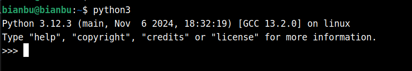

The Bianbu ROS system includes a default Python interpreter. You can access it by typing python3
in the terminal:
Exit the interpreter with Ctrl + D

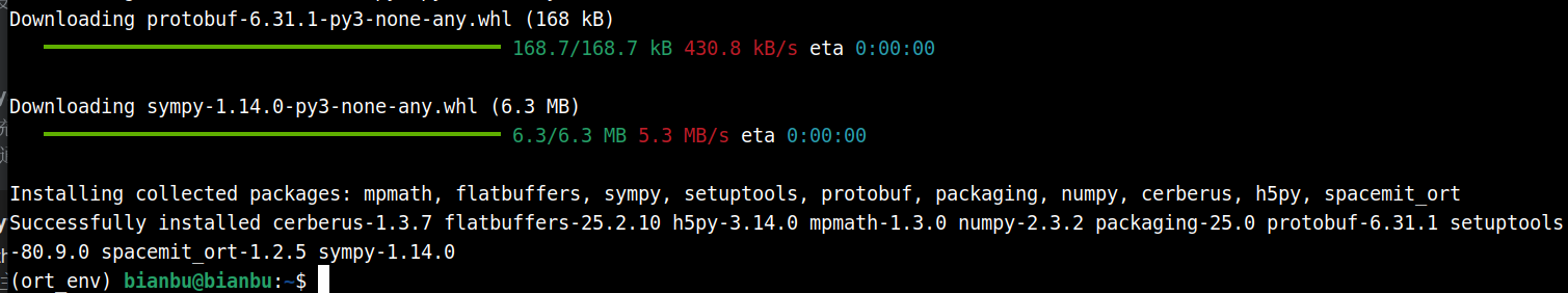

Install
spacemit_ort
pip install spacemit_ort
If successful, the terminal will show an installation summary similar to this:
