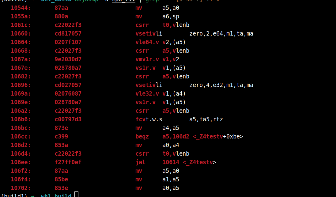

g++ -march=rv64gcv -mabi=lp64d cpu_rvv.cpp -o cpu_rvv
Disassemble to verify RVV instructions:
objdump -d cpu_rvv | grep '^ *[0-9a-f]*:.*v'
Example output:
If you see instructions containing .v, the program is using RVV successfully.
