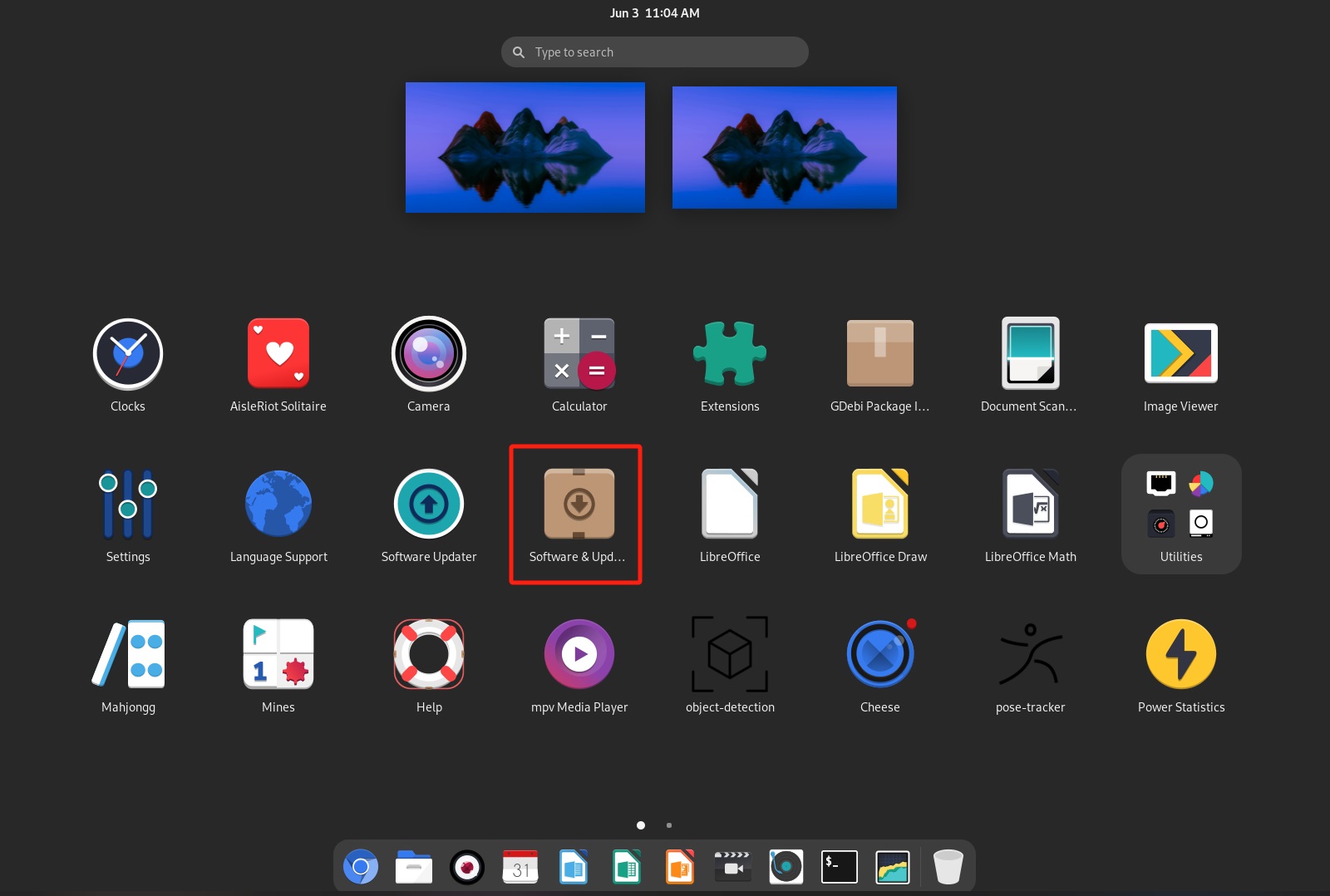

  1. Open the Software & Updates application
    • If the application cannot be launched, ensure the system is running version 1.0.15 or above. Software and Updates

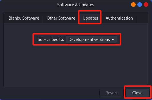

    • Switch to the Updates tab.
    • In the Subscribed to drop-down menu, select the target version (e.g., Development versions).
    • Click Close to save the changes and exit. Subscribe

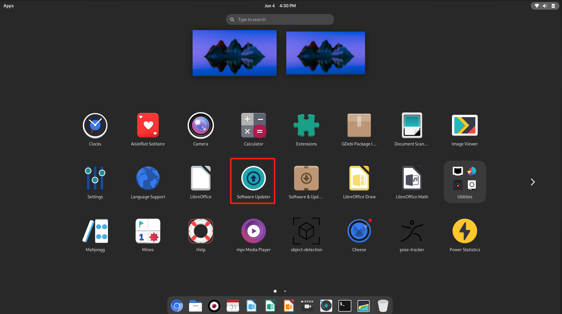

  2. Launch the Software Updater application.

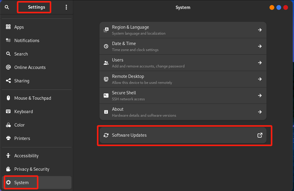

    Updater Alternatively, you can launch Software Updater via SettingsSystemSoftware Updates. Updater01

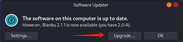

  4. If a new version is detected, click Upgrade... to begin.
    Update Prompt
    To cancel the upgrade, click OK.
