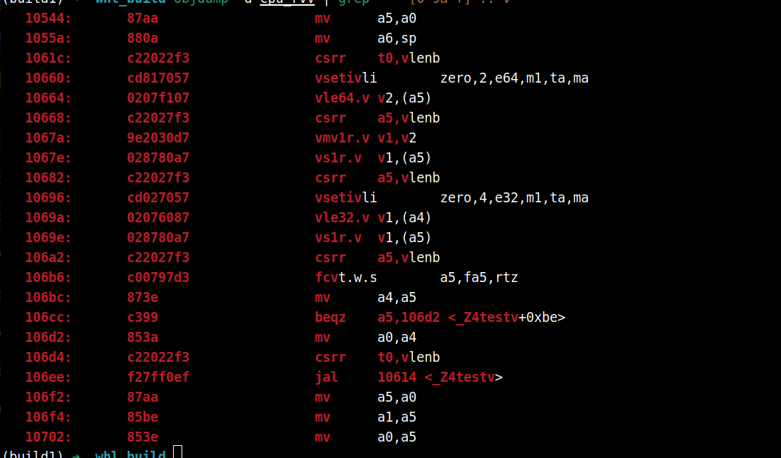

测试程序:
#include <stdio.h>
#if !defined(__riscv) || !defined(__riscv_v)
#error "RISC-V or vector extension(RVV) is not supported by the compiler"
#endif
#if !defined(__THEAD_VERSION__) && defined(__riscv_v_intrinsic) && __riscv_v_intrinsic < 12000
#error "Wrong intrinsics version, v0.12 or higher is required for gcc or clang"
#endif
#include <riscv_vector.h>
#ifdef __THEAD_VERSION__
int test()
const float src[] = { 0.0f, 0.0f, 0.0f, 0.0f };
uint64_t ptr[2] = {0x0908060504020100, 0xFFFFFFFF0E0D0C0A};
vuint8m1_t a = vreinterpret_v_u64m1_u8m1(vle64_v_u64m1(ptr, 2));
vfloat32m1_t val = vle32_v_f32m1((const float*)(src), 4);
return (int)vfmv_f_s_f32m1_f32(val);
#else
int test()
vuint8m1_t a = __riscv_vreinterpret_v_u64m1_u8m1(__riscv_vle64_v_u64m1(ptr, 2));
vfloat32m1_t val = __riscv_vle32_v_f32m1((const float*)(src), 4);
return (int)__riscv_vfmv_f_s_f32m1_f32(val);
#endif
int main()
printf("%d\n", test());
return 0;
保存为 cpu_rvv.cpp
执行编译:
g++ -march=rv64gcv -mabi=lp64d cpu_rvv.cpp -o cpu_rvv
反汇编:
objdump -d cpu_rvv | grep '^ *[0-9a-f]*:.*v'
.v 的即为 v 指令
