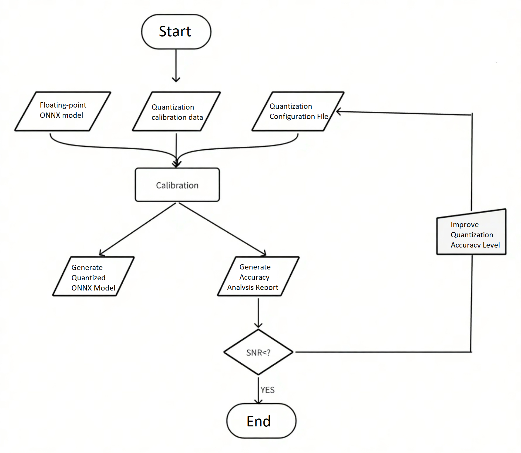

Workflow
The quantization process follows these steps:
Model Quantization Example
