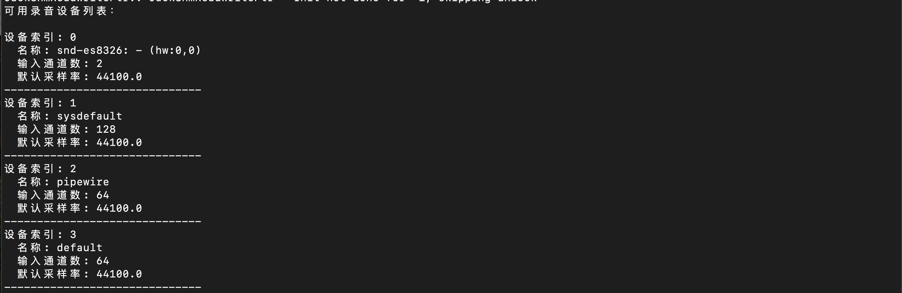

Method 2: Run Script for Automatic Search
Execute the following script to enumerate recording devices in the system:
python3 01_search_device.py
