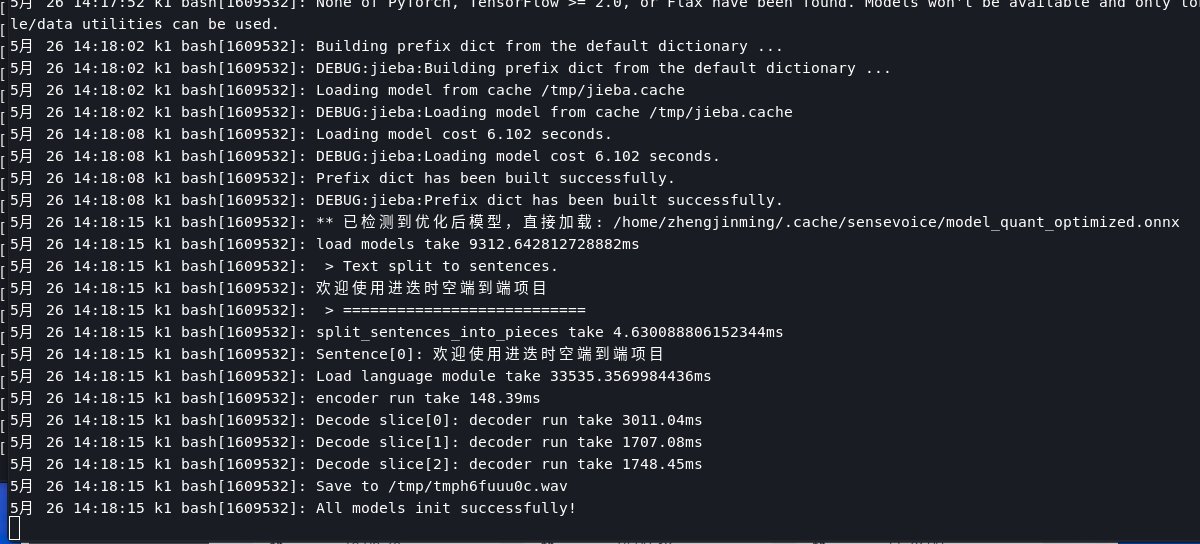

journalctl --user -u demo_serve -f
Observe the system log until the following information appears:
When the log displays 'All models init successfully!'
, it indicates that the TTS service has started and is ready to use.

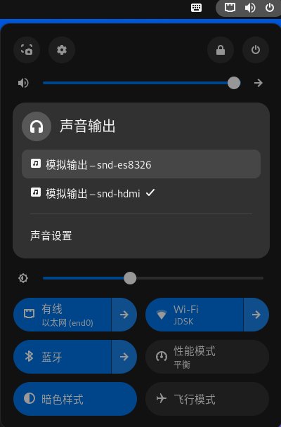

After confirming the device, set the default playback device:
pactl set-default-sink alsa_output.usb-C-Media_Electronics_Inc._USB_Audio_Device-00.analog-stereo
Method 3: Switch Playback Device via Graphical Interface (Recommended when display is available)
Click on the device in the interface to switch the default playback device.
