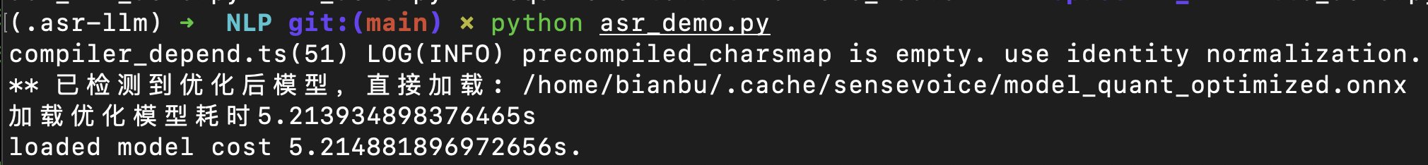

Run the ASR example:
python 03_asr_demo.py
After the program starts, press Enter to begin recording. The integrated VAD functionality will automatically determine if there is human speech and stop recording during silence.
