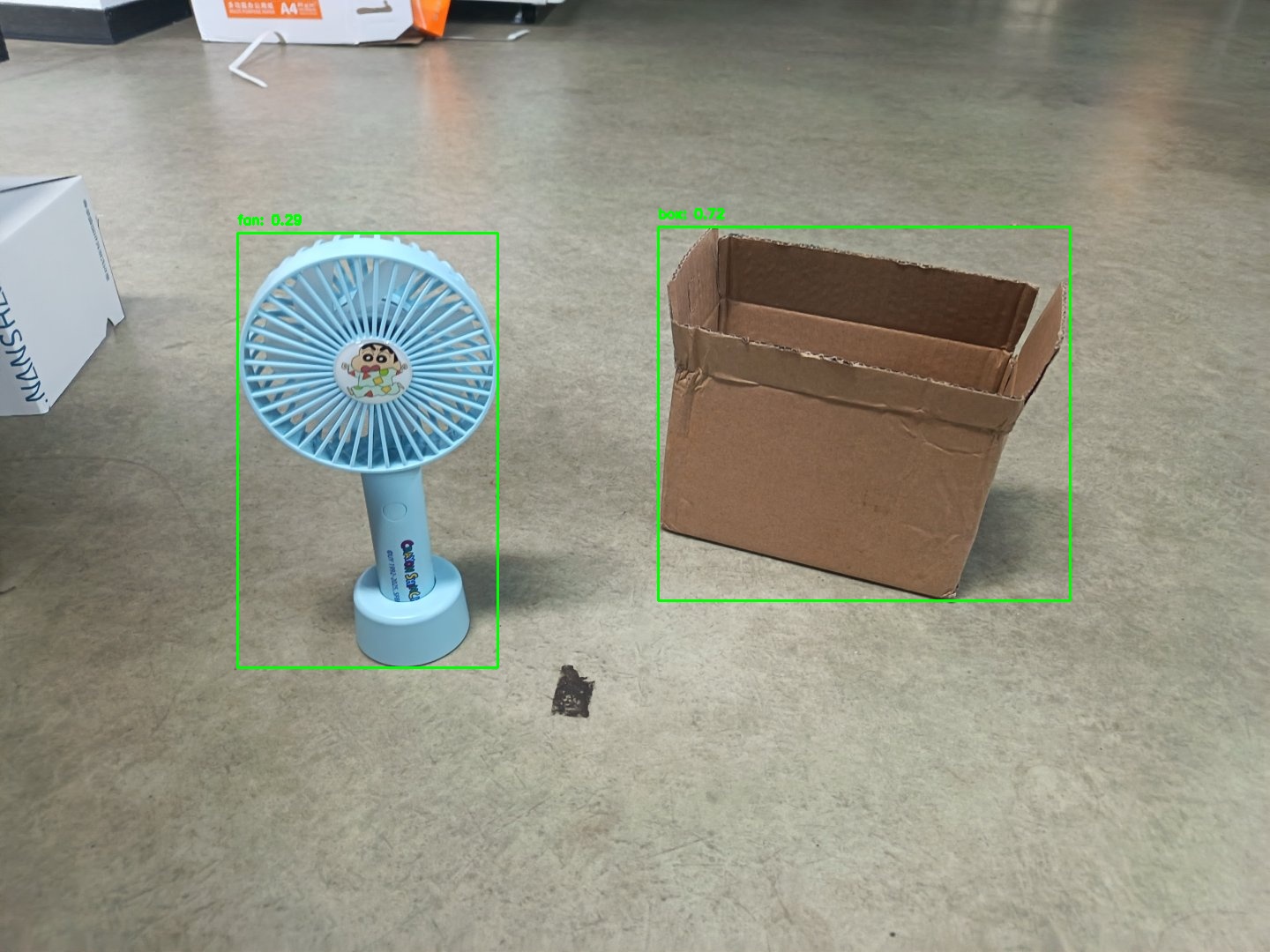

The detection results are saved as yoloworld_result.jpg in the current directory.
Terminal output shows detection details:
(test3) bianbu@bianbu:~$ ros2 launch br_perception yoloworld_infer_img.launch.py img_path:='./test2.jpg' class_names:="[fan, box]"
[INFO] [launch]: All log files can be found below /home/bianbu/.ros/log/2025-08-13-16-09-04-608187-bianbu-217760
[INFO] [yoloworld_img_node-1]: process started with pid [217761]
[yoloworld_img_node-1] /home/bianbu/test3/lib/python3.12/site-packages/clip/clip.py:6: UserWarning: pkg_resources is deprecated as an API. See https://setuptools.pypa.io/en/latest/pkg_resources.html. The pkg_resources package is slated for removal as early as 2025-11-30. Refrain from using this package or pin to Setuptools<81.
[yoloworld_img_node-1] from pkg_resources import packaging
[yoloworld_img_node-1] All model files already exist and do not need to be downloaded
[yoloworld_img_node-1] conf_threshold: 0.2, iou_threshold: 0.45, class_names: ['fan', 'box']
[yoloworld_img_node-1] Init Model ..................
[yoloworld_img_node-1] all time cost:0.697995662689209
[yoloworld_img_node-1] x_min:980, y_min:469, width:466, height:424, label:box, confidence:0.72
[yoloworld_img_node-1] x_min:417, y_min:510, width:294, height:493, label:fan, confidence:0.29
[yoloworld_img_node-1] The object detection results are saved in: det_result.jpg
[INFO] [yoloworld_img_node-1]: process has finished cleanly [pid 217761]

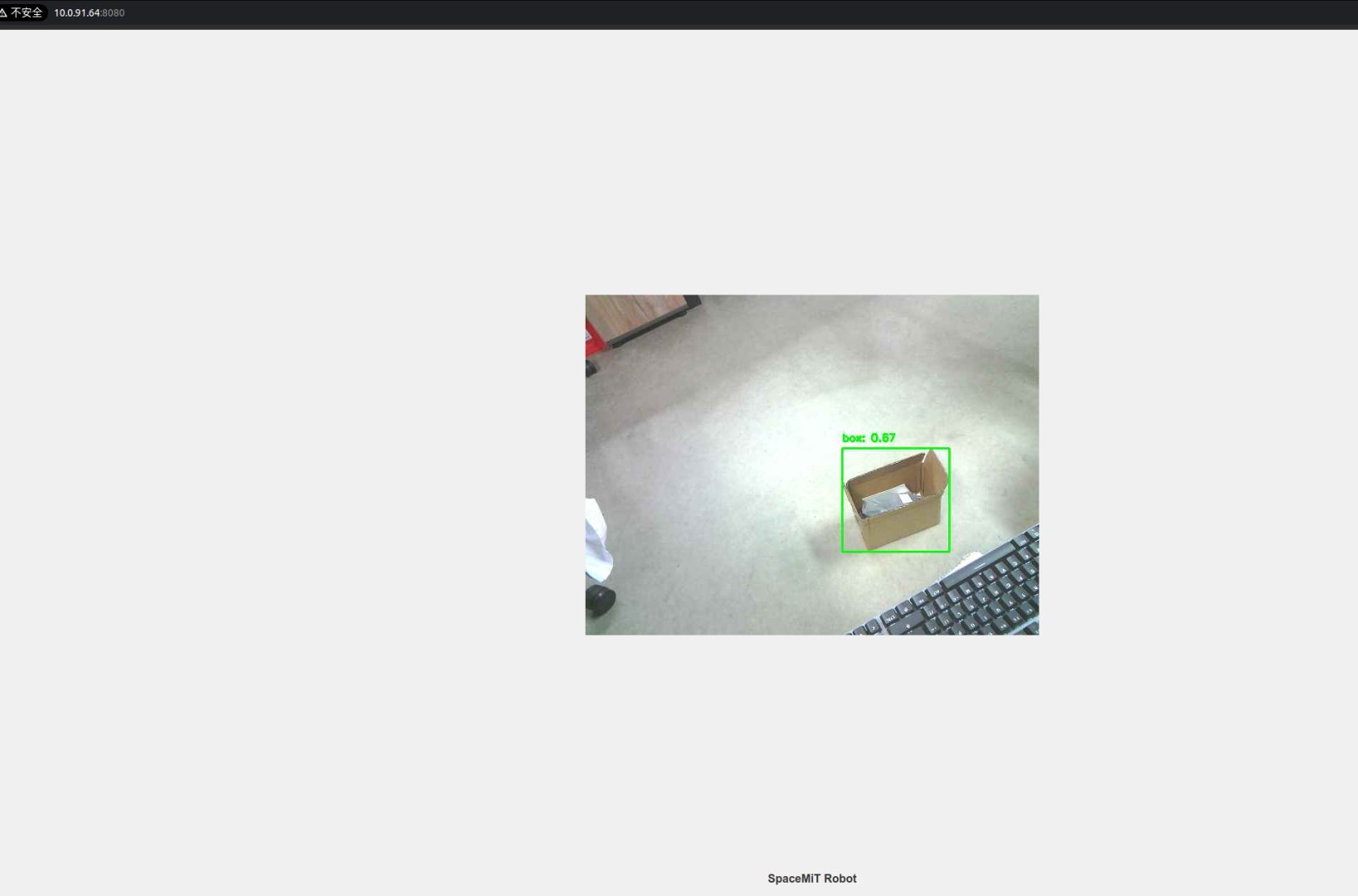

Terminal 2 - Launch web visualization:
ros2 launch br_visualization websocket_cpp.launch.py image_topic:='/result_img'
The terminal will print the message as:
Please visit in your browser: http://<IP>:8080
Open a browser and visit the URL shown in the terminal (e.g., http://<IP>:8080) to view results.
