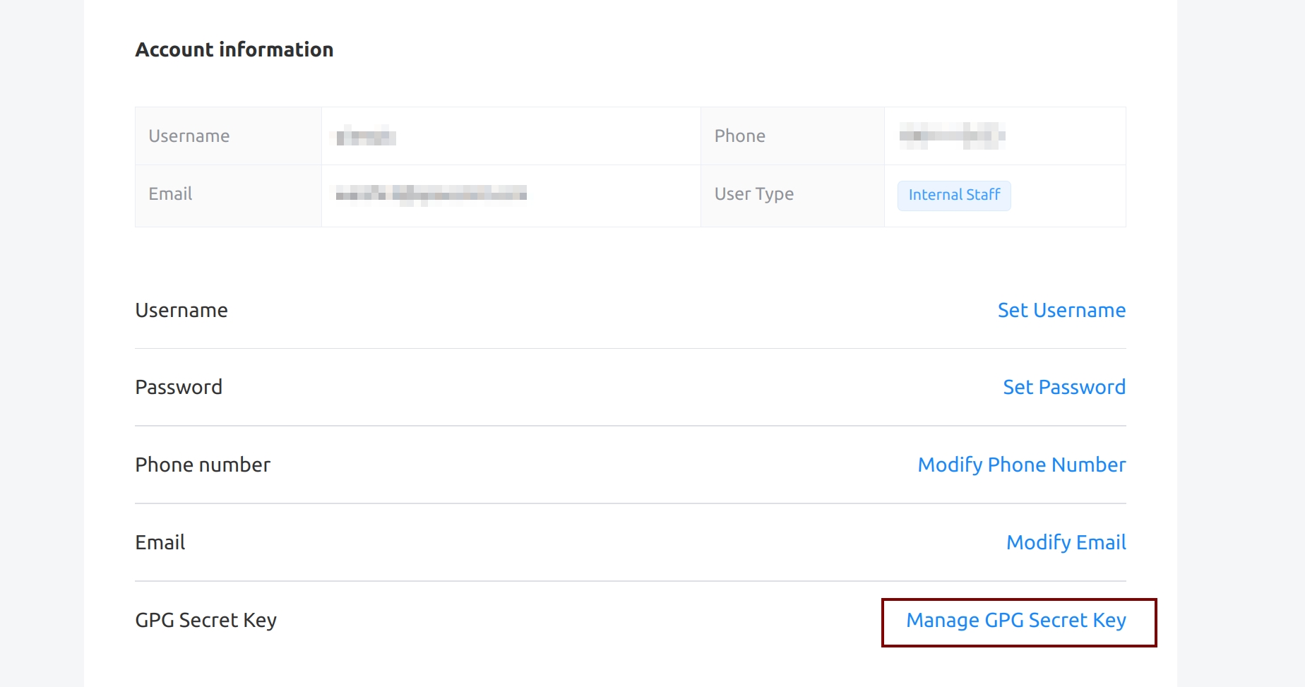

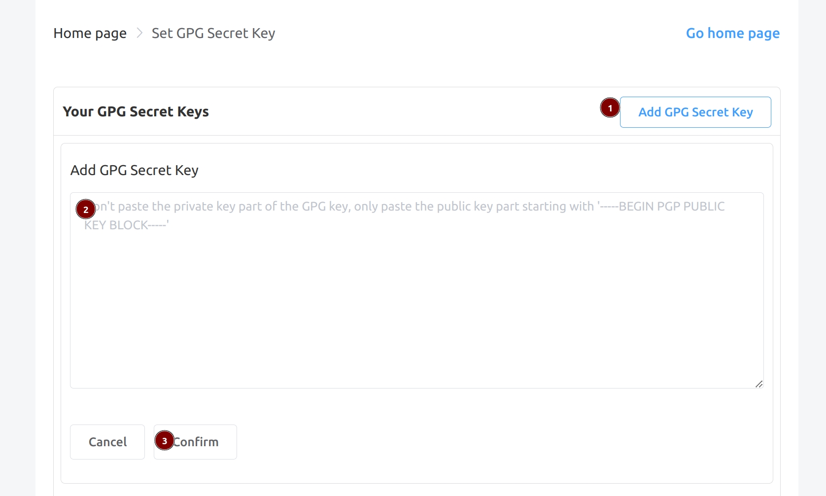

Click https://developer.spacemit.com/auth/#/user/userInfo and follow the illustrated steps to add the GPG public key:
Figure 1: GPG Public Key Import Example
Note: The pasted content should include the BEGIN and END lines at the beginning and end.
Figure 2: GPG Public Key Import Example
