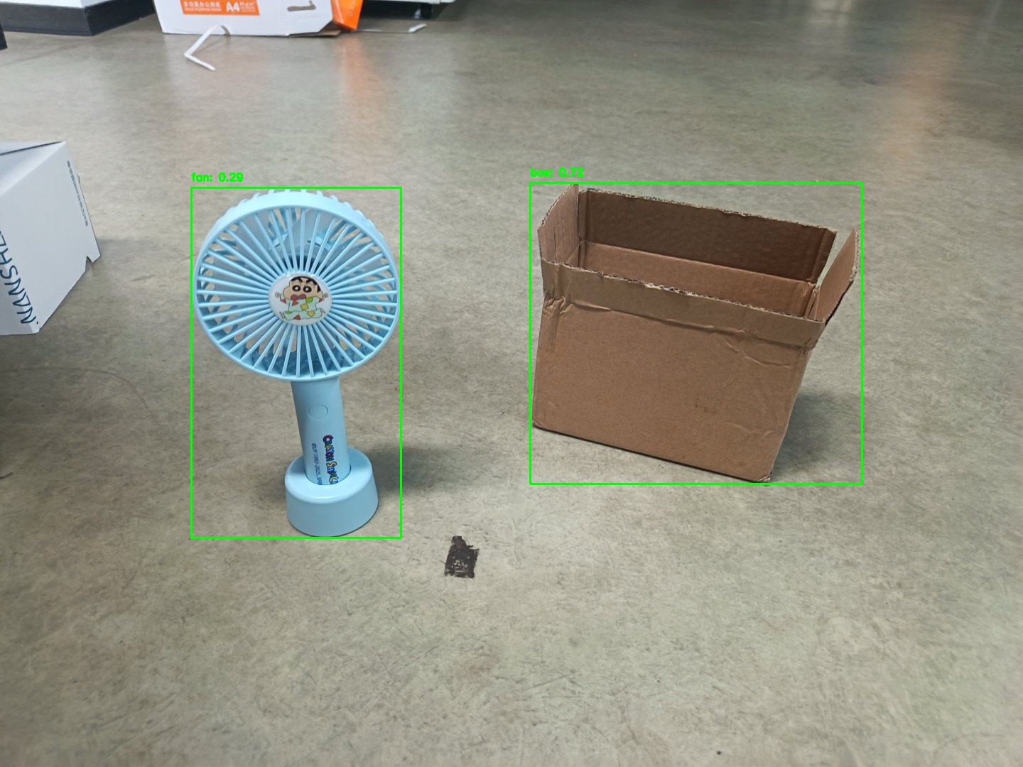

ros2 launch br_perception yoloworld_infer_img.launch.py \
img_path:='./test2.jpg' \
class_names:="[fan, box]"
中,如图所示。
终端打印如下
(test3) bianbu@bianbu:~$ ros2 launch br_perception yoloworld_infer_img.launch.py img_path:='./test2.jpg' class_names:="[fan, box]"
[INFO] [launch]: All log files can be found below /home/bianbu/.ros/log/2025-08-13-16-09-04-608187-bianbu-217760
[INFO] [launch]: Default logging verbosity is set to INFO
[INFO] [yoloworld_img_node-1]: process started with pid [217761]
[yoloworld_img_node-1] /home/bianbu/test3/lib/python3.12/site-packages/clip/clip.py:6: UserWarning: pkg_resources is deprecated as an API. See https://setuptools.pypa.io/en/latest/pkg_resources.html. The pkg_resources package is slated for removal as early as 2025-11-30. Refrain from using this package or pin to Setuptools<81.
[yoloworld_img_node-1] from pkg_resources import packaging
[yoloworld_img_node-1] All model files already exist and do not need to be downloaded
[yoloworld_img_node-1] conf_threshold: 0.2, iou_threshold: 0.45, class_names: ['fan', 'box']
[yoloworld_img_node-1] Init Model ..................
[yoloworld_img_node-1] all time cost:0.697995662689209
[yoloworld_img_node-1] x_min:980, y_min:469, width:466, height:424, label:box, confidence:0.72
[yoloworld_img_node-1] x_min:417, y_min:510, width:294, height:493, label:fan, confidence:0.29
[yoloworld_img_node-1] The object detection results are saved in: det_result.jpg
[INFO] [yoloworld_img_node-1]: process has finished cleanly [pid 217761]

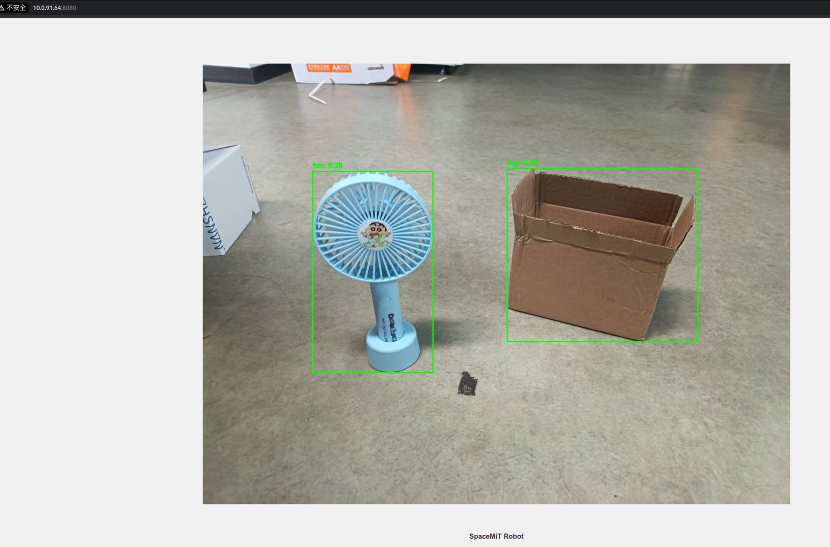

Web 可视化推理结果
启动推理发布节点(终端 1):
publish_result_img:=true \
启动 Web 可视化服务(终端 2):
ros2 launch br_visualization websocket_cpp.launch.py image_topic:='/result_img'
终端提示访问地址:
Please visit in your browser: http://<IP>:8080
打开浏览器输入 http://<IP>:8080
,即可查看实时推理图像结果。

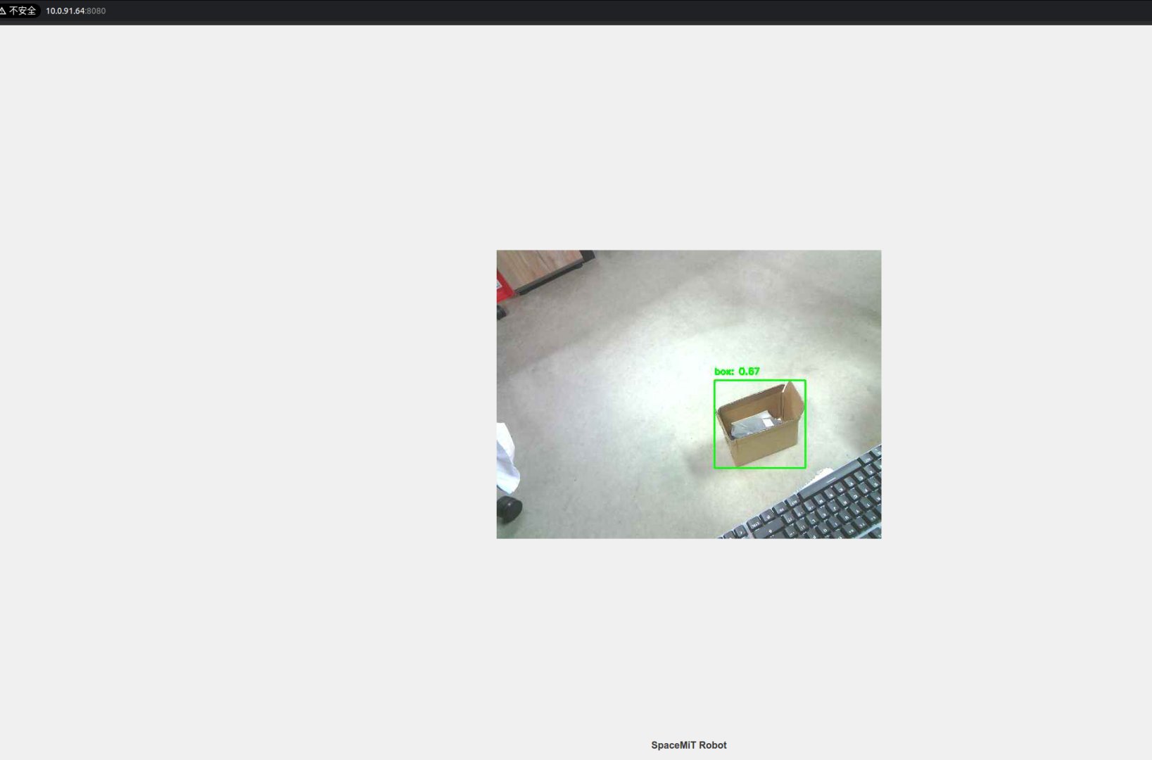

视频流推理
启动相机(USB 示例)
ros2 launch br_sensors usb_cam.launch.py video_device:="/dev/video20"
启动推理并发布结果
启动推 理(终端 1):
ros2 launch br_perception yoloworld_infer_video.launch.py \
sub_image_topic:='/image_raw' \
result_topic:='/inference_result' \
class_names:="[box]"
Web 显示(终端 2):
终端提示访问地址:
,即可查看实时推理图像结果。
