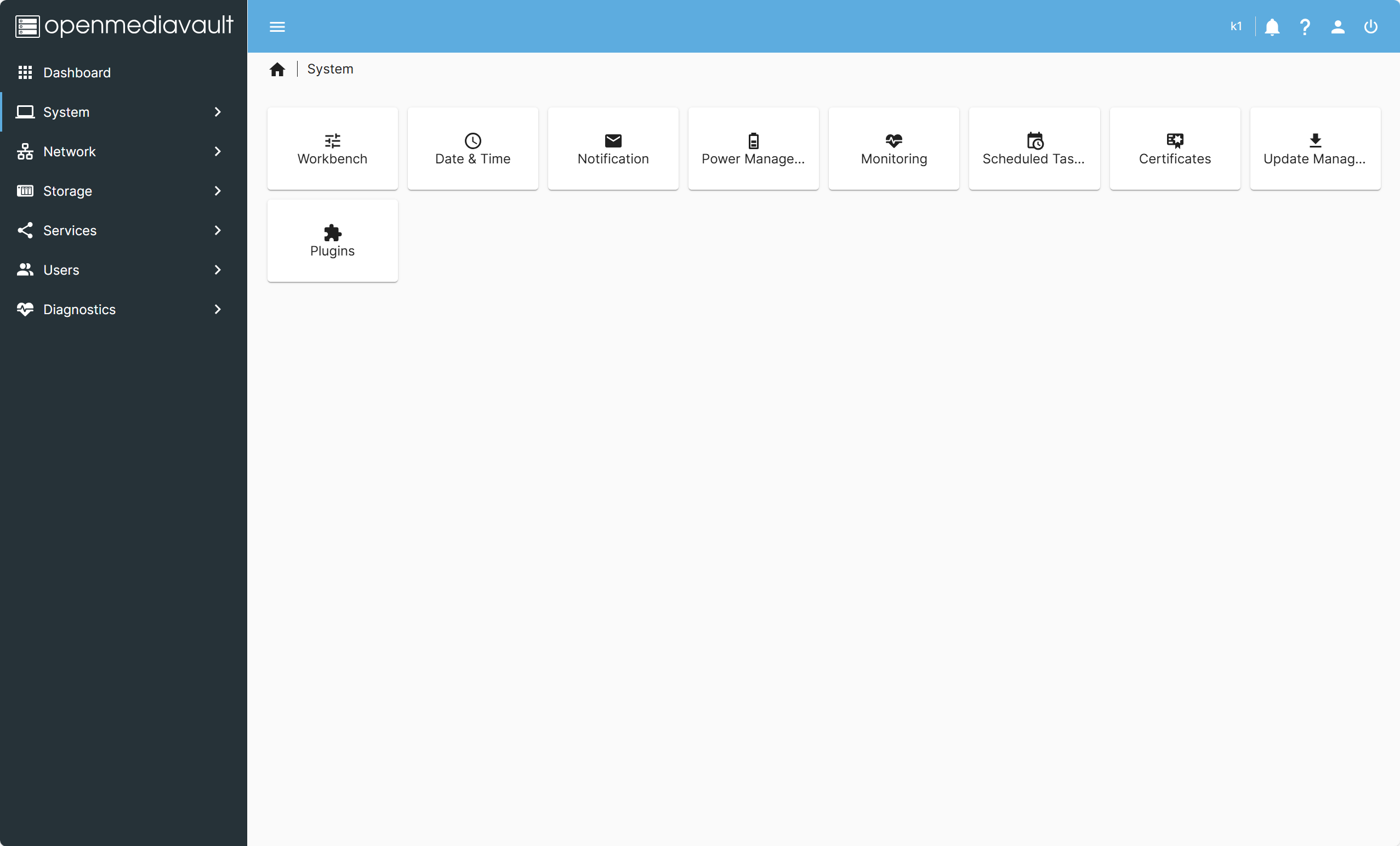

Openmediavault Web Login
Bianbu NAS provides full NAS functionality through the Openmediavault application, providing an easy-to-use web interface for managing NAS services.
Login Steps:
Make sure your NAS is connected to the network Plug in an Ethernet cable or connect to Wi-Fi (ensure it’s the same network as your computer).
Open a web browser (Chrome/Firefox/Edge) Enter the address:
http://HOST_IPin the address bar to access the Openmediavault web interface.Note: Refer to "How to check the IP address?" if you are not sure what
HOST_IPis. -
Enter login credentials Username:
adminPassword:openmediavaultClick Login to access the management interface, as shown below.
For more features, tips, and technical help, visiting the Openmediavault official website.
