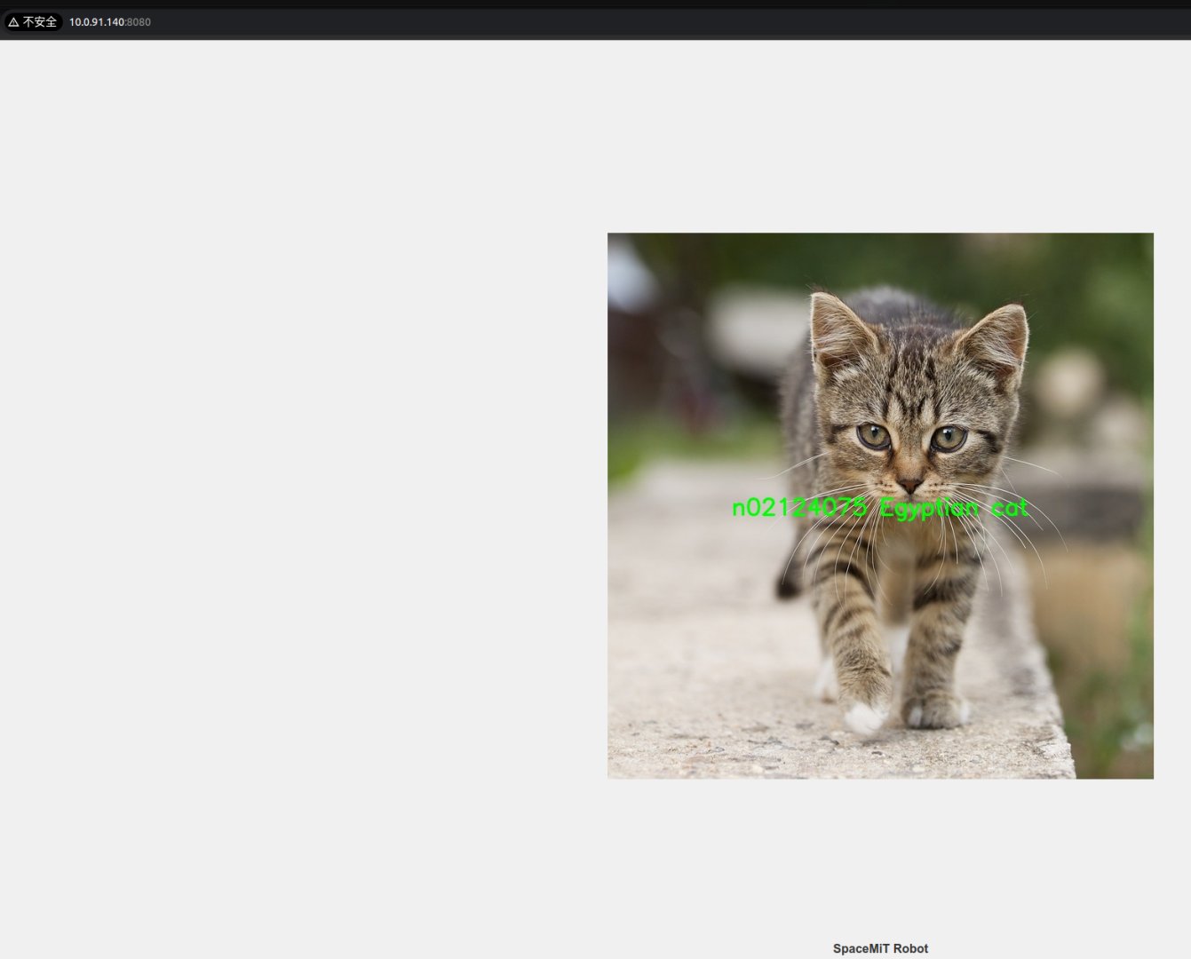

Web 可视化结果(可选)
启动图像推理(终端 1):
ros2 launch br_perception infer_img.launch.py \
config_path:='config/classification/mobilenet_v2.yaml' \
img_path:='./kitten.jpg' \
publish_result_img:=true \
result_img_topic:='result_img' \
result_topic:='/inference_result'
启动 Web 可视化服务(终端 2):
ros2 launch br_visualization websocket_cpp.launch.py image_topic:='/result_img'
终端输出:
Please visit in your browser: http://<IP>:8080
打开浏览器访问 http://<IP>:8080,即可查看分类渲染图像。
