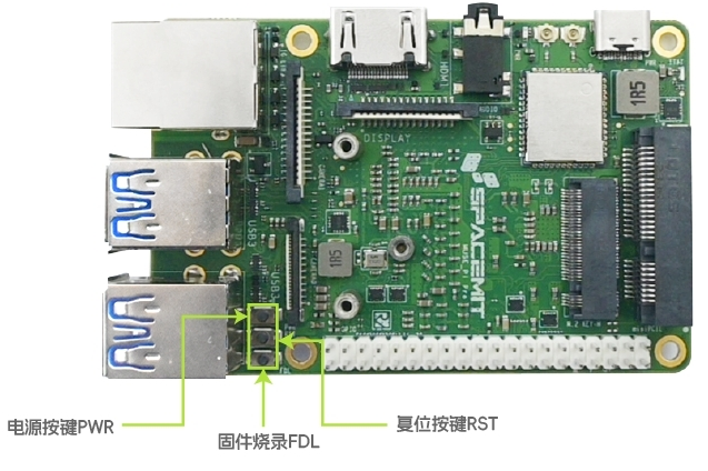

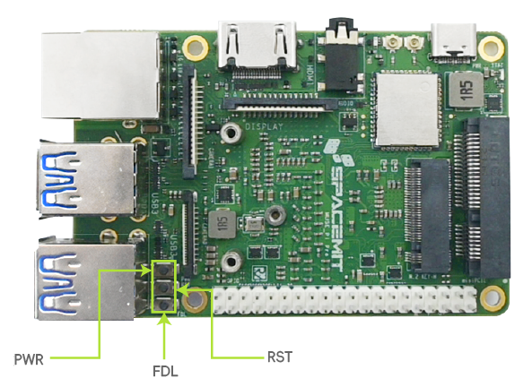

The Muse Pi Pro development board is equipped with multiple buttons.
For firmware flashing, you will mainly use:
  • FDL (Firmware Download) button
  • RST (Reset) button
The figure below shows their locations on the board:
